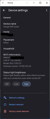

nekkron
While the Home app states this is a Nest Wifi router, when selecting the router & point it indicates it's a Google Wifi router.
As you can see, the router is model NLS-1304-25 (Google Wifi)
AbigailF
Hi nekkron,
Thanks for the details. Based on the screenshot, it hasn't been set up yet. You will need to factory data reset your 3rd Google Wifi point first and it should have a pulsing blue light. After that, you should be able to set it up using your Google Home app. Let us know how it goes.
