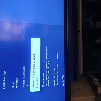

Kostaman
Solved with a cheap Xiaomi Mi TV Stick 4K 2nd Gen Android 14 .
Running TV Headend Server on a 6 year old box with LibreElec software.
Kodi with TV Headend client  addon.
Waste of time waiting for a fix from these clowns.
How can deinterlacing be working for you when it is not supported by ATV14?
It's not an Android 14 OS problem.
It's a Google software implementation of software incompatible with hardware.
I only received the MI TV stick today and it's working flawlessly
Interesting. It has been understood here for several months that it is an ATV14 issue. From my own experience I have tested a GTV14 Streamer and a CCWGTV HD, both on ATV14, the latter having automatically updated to ATV14 from ATV12, and deinterlacing is not working at all. Would it be possible for you to test on Tivimate? A lot of us use Tivimate as the client app for our HDHomerun/Tuner card-TVHeadend setups. Is your TVHeadend server receiving interlaced DVB-T2, 1080i25?
