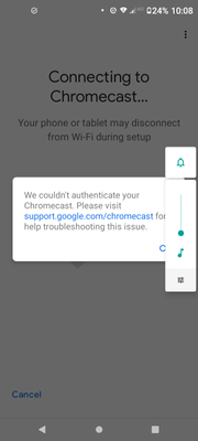

I tried removing one of my devices from Google Home and then got this message when I tried to add it again:

However, I'm getting the following error: Unable to authenticate Chromecast. Go to support.google.com/chromecast to resolve the issue

Me dice que tengo que autenticar chromecast

The app finds the device, but then says "cannot authenticate".........I've tried uninstall ingredients and re installing the app to make sure any updates have been completed, but still nothing
