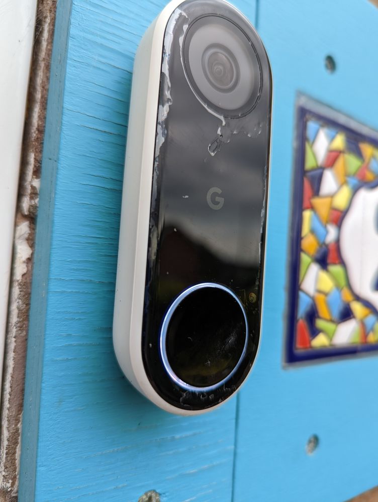

My Nest Hello is peeling. Don't know when it started, but a guest told me about it a few weeks ago. I called support and was told that nothing can be done since it still works properly and is out of warranty. Purchased in Sep 2019. Apparently this is a known defect but support wasn't able to help me. Since I purchased from Costco, I might be able to take it back to them for a refund as I don't think they carry this anymore. With the refund I might buy a competitors product that doesn't have this issue or that at least stands by their product. I removed as much the flaked material as I could on the right side...

I suspect the clear protective film was not removed when the Hello was installed, the film and adhesive have now become brittle with the UV light over a period of 2 or 3 years, and it appears that its laminating. Its not obvious that there is a clear film on the Hello. If its not removed at install time, you will see this issue over time.

It is definitely NOT the clear protective film. When I first saw posts on peeling and delimitation on Google Nest Hello Doorbells last year, I too mistakenly surmised that it might be that the clear protective film was not removed. But when it started to happen to one of our Nest Hello doorbells a month ago--where I know we removed the protective film--I realized it's the surface of the doorbell that's peeling. Besides, the protective film is flat and not curved over the beveled edges, where our doorbell started peeling. And the protective film covers only portions of the doorbell's surface, as I noticed when we installed our third Nest Hello early this year.
There are posts on other Internet forums about peeling Google Nest Hello Doorbells going back to 2020; this is a known issue.
Just did a google image search "google nest hello peeling" I looked at the first half a dozen images, they are all the protective film peeling. The film does cover the bevelled edge, its not obvious to remove it. I agree its a known issue, if it was obvious to remove the film, eg a different colour, there wouldn't be pictures of it peeling after a year or so in sunlight.
@-Craig
I've seen those images also. However, the peeling on our second Google Nest Hello Doorbell is most definitely NOT due to the protective film peeling. I removed it when I installed it. And the protective film that I recently removed when installing our third Nest Hello on Dec. 31, 2021 was flat, did NOT extend to the beveled edge (much less curve over it), did not cover much of the camera (but rather the camera lens and the button and a little more), and came off in two pieces. I noticed that because of all the posts in this forum and elsewhere.
The images I have seen online are where the film has not been removed, you can see the outer edges around the camera, and the film extends over the bevel. The issue is its not obvious to remove when installing the doorbell, its not in instructions, not on youtube videos, so its not getting removed by users. There will be a chemical reaction with the film and the UV sunlight, and it will start to peel. Yes lots of posts about it, yes a known issue, which is possibly why the unit you installed in 2021 had a different protective film covering, as Google became aware of this issue?
@-Craig
Respectfully, I disagree. The images posted everywhere online, showing delamination that extends over the beveled edge, is exactly what is occurring on one of our Google Nest Hello Doorbells. I agree that it looks like protective film that is peeling, and that's what I thought months ago.  In fact it is the surface coating on the doorbell that is delaminating. I have now installed a total of four Nest Hello doorbells in the last three years, and have removed the protective film in each case, and ONE of our doorbells is delaminating.
I've removed protective film on numerous products, and do not recall any that had a compound 3-dimensional curve wrapping around the beveled edge right up to the surrounding white housing on the side that would account for the many, many reported instances of delamination on Nest Hello doorbells.
I just checked Google Nest's install video for the Google Nest Hello Doorbell (wired), accessible from the Google Nest Help website. It's dated March 15, 2018. It shows the protective film with a clearly visible black tab at the top of the doorbell (at 0:23 in the video). It's pretty hard to miss, and if it were left on, there would be plastic tab at the top of our doorbells.
https://www.youtube.com/watch?v=TwPS46AZy2o
Simps
