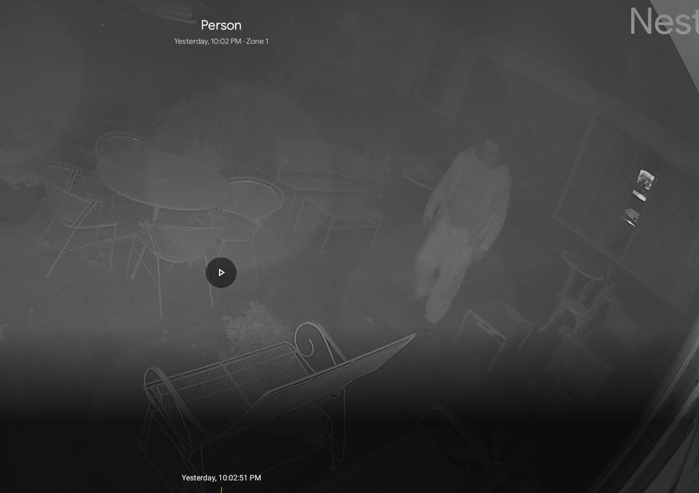

rvalkenburg
I have 4 outdoor battery cameras around my property, none are viewing through a window. Not much lighting at night as I do not live in a busy city, All 4 are in different parts of my property so the lighting is not the same for each either, driveway may have a street light but backyard there is nothing. All cameras auto switch to night vision, no problem, but the video is very dim, cloudy, washed out and almost impossible to see a person, 1000 times worse than the older IQ outdoor cameras. I would have assumed a bit less quality due to battery consumption but not this bad.
rvalkenburg
Here is a clip from me walking by the camera last night 10pm EST
EmptyNester
Silver Product Expert
Hello Rvalkenburg, I'm just another user here but I have a lot of experience with these cams. That is definitely not how the image from the camera should look.  It should be much more clear.  There is a chance that the IR LEDS are catching some kind of  reflection from a surface (like the eves on the building) that is making that happen.  Humor me and take the camera down from where it is mounted and watch the image on your phone at the same time. Move the camera around pointing it in different  directions and see if the image gets clear.

Hi MplsCustomer,  I have both the old and new cameras and the picture quality I'm getting is a lot better than the example rvalkenburg is showing (above). To me ,what I'm seeing is not useable and I would return that camera in a heart beat. (Just my opinion).

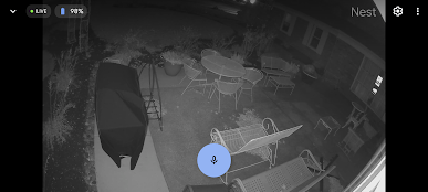

rvalkenburg
Well figured it out.... All 4 of my Battery Nest cameras I installed with the Wasserstein Anti-Theft mount which Google says to use if camera installation is over 6.5" high. So I took of the mount and crystal clear, the shield on the top of the mount must be interfering with the night vision sensors. I cut off the overhang on the mount and works perfect, still clear and can still secure the cameras. I have not seen anywhere people complaining about these anti-theft mounts, but that was the problem.

EmptyNester
Hi Rvalkenburg,  I'm so glad you were able to figure this out.  That image is much much better.  I recall about 2 months ago there was a thread (I think posted on this forum) of people reporting that exact same issue with the Wasserstein mount.   I think the fix the problem with a pair of scissors and simply clipped that little bit that hang's over the top of the camera that the IR Led light was reflecting off of.
Glad to hear it is not a design issue with the camera.
