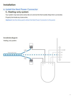

Need help with below photo, if it’s compatible to the nest

I'm not sure which Nest thermostat you refer to by 'normal'.

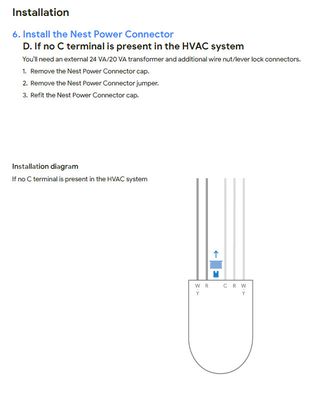

If you mean the Google Nest Thermostat, you will need the Nest Power Connector. You won't need an external transformer if there is a 24vac terminal. If there isn't, then you will need the external 24vac transformer.
If you need to use an external 24vac transformer, you will want to wire it like the following.
If you don't need the external transformer, you will want to wire it like this.
