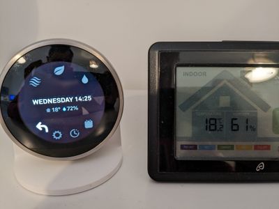

Hi, actually yes. One more question is re the humidity percentage displayed. Is there any way it can be calibrated? It's showing 74 at the moment but the actual is 63% (measured by two different devices). Thank you

Hi and thank you for your reply. I followed the above but still showing 11 percent higher. Any other options that l have? Thank you
AlexD
You can try moving it to some different locations, just to check if the humidity reading changes on both devices and if they are closer or match in another part of the location. If they still have a wide difference in the readout, make sure to take a picture of the 2 devices side by side with their readings.
SerhiyKo
I have been doing that for the last 10 days I think, the difference is stable - 10-12% higher on the Nest thermostat

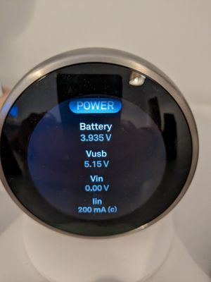

Ok, I have been in touch with my senior colleagues. They asked for an additional detail. Please go to Settings> Technical info> Power and take a picture of the readings you see there.
SerhiyKo
Sure, here you go
 it is powered by original google stand (purchased from Google store)
AlexD
Thanks. The power readings look good. I will go ahead and forward this to my senior colleagues as well and see what they suggest next.

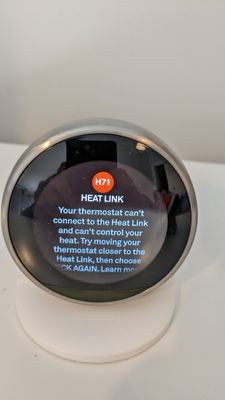

Can someone please call me and walk me through the installation of a new thermostat. I am not able to connect it to heat link. My system is not working anymore. The electrician will cost me a fortune
SerhiyKo
i got a replacement but it doesn't connect to heat link. Should I require electrician to open a heat link to check?
When trying to pair to heat link, l always get an error after waiting for a minute or two. Apparently the replacement display you sent is faulty two. Should I return to use the original display even though it's showing incorrect humidity? Please advise. I cannot just sitting here and waiting for your reply for hours
They will never pair if you have either a new Heat Link or Display, as they are no longer a matched pair! You have to setup as ''Replace Heat Link''. When you get the error H71 look for that in the list, and add the 6 digit code from your Heat Link.

Thank you for your reply. That what I did:
"Replace heat link", next "Continue", next l entered 6 digits from heat link, but I keep getting the same error... Tried to repeat these steps couple of times, no luck.
OK, do you have a blue pulsing light on the heat link?
Try this also…… reset the heat link by pressing the button and keep held down until the light pulses blue, takes about 30 seconds plus.   Do not release the button until the light pulses. Do this twice.
Then remove the display from the stand. squeeze the display from front to back, and keep pressed until you see the house logo, then release. Do this also twice.
Replace the display to the stand and try pairing again.
Should this not pair, then you will have to connect a wire from terminals T1 & T2 on the heat link to the display base.
You only need a temporary wire just to connect, then once paired you can remove.
That will work, but try the reset first.
Pressed heat link button and hold it 30 seconds until it started flushing blue, paired. Thank you
