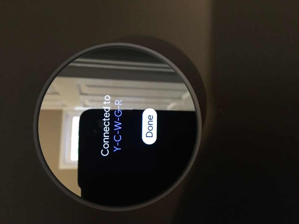

Hi, Google Nest thermostat has been “intermittently” showing  No Power with error code E298.  I connected extra wire to Common on both furnace and Thermostat hoping to resolve this issue.  Query of wiring diagram shows all wires are working, however, I still get the above error code.  Went through the trouble shooting guide, nothing out of the ordinary.  Any ideas?

E errors a typically a wiring problem.  You saying that the Nest recognizes all the connected wires and all wedges are Green?

YCWGR are all blue.  I have a first generation Nest.
If I remember correctly, on the first generation, it shows you wires with checkmarks in boxes, I think

I noticed that I had to constantly replace the batteries.  After researching, I added the COM (lavender wire) at both ends.  Still indicates intermittent “No Power E298.”
Do you have a Volt Ohm Multimeter? If so, at the thermostat check AC power between R and C wires.

Shows 27.7 volts.
Well, then allis good. Make sure the wires, the bare copper ends, are straight and fully inserted.  Other than that, there is not a reason for this E type error.  My Nest Pro manual does not show me an E error with that high of a value.
