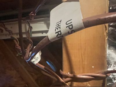

I’m not sure if this will help the question or make it more confusing, but here are pictures of the Aprilaire controller and the labeling as they come into the back of it.  Thank you all again for your help!

Your two thermostats are talking to the Aprilare zone controller. You will simply Install the Nest Learning Thermostat, Identify your system as a Heat Pump, having Auxiliary Heating and Emergency heating.  Your wires being used are R,C,G,Y,E,Aux, and O/B. You might need to verify the programming of your old thermostat to see if it energizes the O/B wire for heating or cooling.

@CoolingWizard  The black and white wires were terminated together in the zone controller.  Doing as you recommended worked like a charm!  Thanks so much for everyones input.
