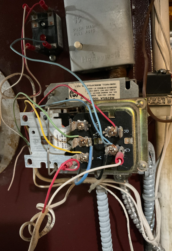

Sure thing, this mess is hanging off the side of our furnace :). We're on a two zone system. Themostats are on the main floor and second floor.
View 1View 1View 2View 2
@Aeromass , as you can see, the Light Brown wire is not connected to anything.  So we can ignore that wire. Your light Blue wire is attached to the C terminal.  The Red wire is on the R terminal. The Yellow wire is on the Y terminal. And the Green wire is on the G terminal. The White wire goes to the relay above.
Your NEST Thermostat would be wired with the Red wire on R or Rc.  The Green wire to G, the Yellow wire to Y or Y1, the White wire goes to W or W1.  The Blue wire to C. The Brown wire does not need to be connected to anything.

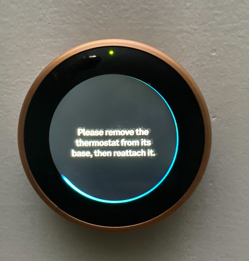

Thanks for your help thus far - I got it wired up as you stated, double-checked that the wires are seated. I'm getting the "Please remove/reattach" message and sweeping blue line on the Nest Thermostat. Also, The dual zone box is making a clicking sound. Any ideas on this one? 🙂 @CoolingWizard Screen Shot 2023-10-11 at 8.56.46 PM.pngScreen Shot 2023-10-11 at 8.56.34 PM.png
@Aeromass ,  Normally the HVAC equipment is wired to the Zone controller and the thermostat is wired to the Zone Controller.  Normally, a zone controller needs its own dedicated power transformer. The wires on the top left are the equipment connections. This is the R,C,Y,G,W of the HVAC equipment.  On the lower left is where your primary thermostat is connected.  It is also where the Zone 1 damper motor is connected. Zone 2 thermostat is connected to upper right side.  If your HVAC contractor did not install a separate transformer for the zone controller, you could be experiencing a power shortage. The nest draws only 200mW of power maximum. That is it much, but if the zone damper motor is drawing to much power and that could be causing the relays to toggle.
This can only be diagnosed by measuring the voltage and the current at the zone controller when the thermostat is calling for heat or cooling.
Now, here is the problem with most older zone controllers.  They require the Zone 1 master thermostat to set the system mode.  That is heating or cooling mode.  It does this by connecting the R to the B wire for heating. It connects. The R to Onto set the cooling mode.  The Nest thermostat does. It operate this way. When we run into this situation, we have to install an ON-off-ON switch. This switch has O on one end and B at the other end.  R is in the middle.  This is the system mode switch.  Basically most zone controllers are not intelligent systems.

Jumping in on this issue.
The DuroZone Model SMZ-2SW Zone Control System you have installed is not compatible with any thermostat that doesn't have separate 'O' and 'B' terminals, including all of the Nest thermostats.
There is a modification that can be done that allows a Nest thermostat to be used but it isn't a simple change in wiring.
I have attached a link to the manual for you controller and a link to the Instructions on how to modify the wiring so you can use a Nest Thermostat. You will want to use the top right diagram for the Nest
