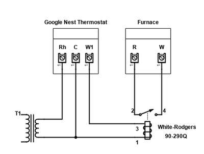

One big problem with many boilers is that they are looking for a switch closure, and the only way to get it to work is by adding a relay with an external 24 VAC transformer.
Something like this.
Patrick, thanks for the suggestion and the wiring diagram. I fail to see why an external relay might be necessary when a traditional analog thermostat will do the job. And where would that relay go? I'm running a 2-zone system with air. Do multiple relays need to be placed inside the boiler combo? Somehow, I think the introduction of a third wire from the Navien to the Nest(s) may be the answer.
