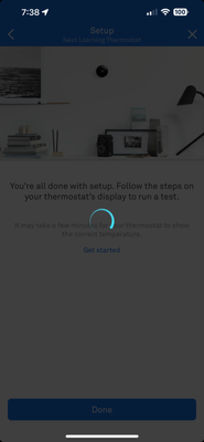

11-12-2024 07:57 AM
Tried this. The app never finished setting up. It’s done this in the past when I tried your suggestion. The app just has a spinning circle and unless you close it and reopen it, the app is buggy. Here’s what I get. Come on Google!!
