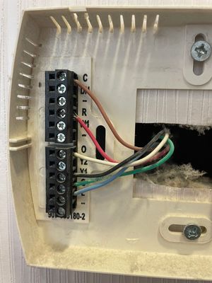

Hi I am trying to install nest in my hair salon amd am little puzzled and hope anyone can help me with the wiring.
R in my original thermostat to nest Rc?
O in original thromostat to nest OB?
L in original thermost - there is no L in nest to which?
I got 6 wires and which color goes to which terminal?
Thanks in advance

Your system is a Heat Pump, your wiring is going to be:
RED Wire to RC
BROWN Wire to C
WHITE WIRE to O/B
BLACK wire to Y1
GREEN wire to G
The Light Blue wire is L and will not be needed.
The AC Cooling Wizard
Thank you brother! So I can just cap the L? Thank You!!!
Yes indeed, cap the L
