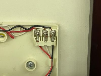

Would my system be compatible with the nest thermostat? (Disregard the non-solid core wire, I will have it soldered). The wires on my system are R, W, and B.

Hello, sorry for replying late, my AC system that provides cooling and heating is from Fuji Electric (model number RDG60LHTA). The controller make and model is fujitsu wired controller Model: UTY-RNNUM

I'm sorry for the late response. We've checked and found that your system is not compatible with our Nest Thermostat based on the photo and make and model of the current thermostat that you've provided.
