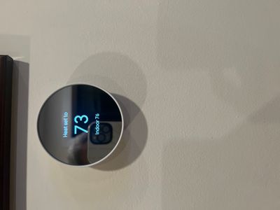

As stated above I have my thermostat set to 73F. My indoor temp on the Nest is reading 76F and yet my heat is turning on and running anyway. Any ideas why that would be? It actually doesn’t feel 76F in here and the temp outside is 49F. Could my Nest be misreading? Is there a way to recalibrate it?

Hi. Thanks for the reply   I ended up calling the help number because this was a little crazy with the heat kicking on when it was a warm day and my setting was for 73F. They had me reset the thermostat. Thanks for the article but none of the headings I could see from your link addressed this particularly perplexing issue. Even the Google nest phone guy was confused. Resetting the device fixed it for now so I’ll be on the look out if it happens again. It’s funny I have a T6 (other brand) thermostat for my other zone and I’ve had zero issues with it. This has been installed for about a month and already it’s getting wonky.  I have also read of problems on here from other customers. Not sure how long I’ll put up with it if there’s more issues. Here’s hoping I don’t have to make a change.
