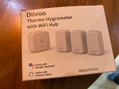

Many many thanks to all who have helped with my question.  I have found and installed an alternative solution    It’s from Diivoo and while it doesn’t talk to NEST it does talk to Alexa and allows me to better manage the NESt system as I now have temperature in 6 rooms
