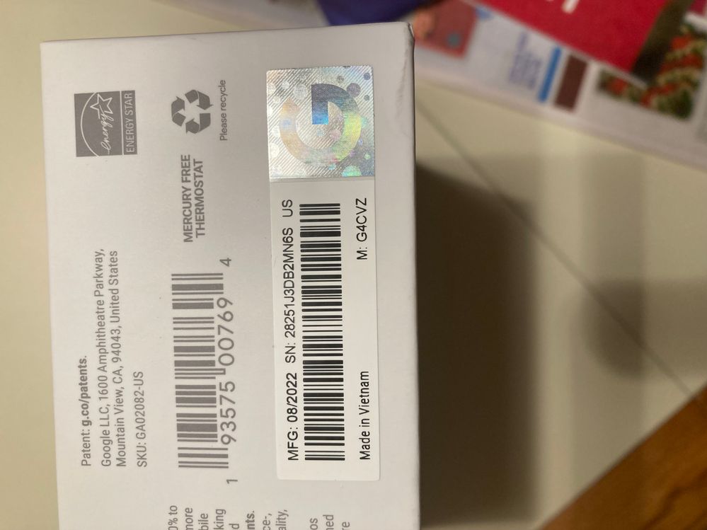

Hello Edward,
I have a forced air, natural gas boiler and a/c. (Carrier). I attached photos of the wiring of my existing thermostat plus photos of the Nest and the label on the box.
The problem that I was concerned about was that the existing thermostat has a jumper between RC and RH (where the red wire is connected).
I contacted my heating / cooling technician and he said that the jumper is not needed.
I then connected all the remaining wires to the Nest thermostat (G Y W R) and turned the system on. Everything works correctly.
Thanks for your reply. If you need any other info send me a message.

Hi StuR,
Thanks for the response. The type of Nest Thermostat that you have requires a C wire. It's possible that that's the reason why you're getting a message saying that it's not compatible. Just to clarify, is it working fine right now?
Edward
StuR
The Nest thermostat is working correctly.   (I have not checked if the air conditioner will work since I have the outside heat exchanger covered for the winter.)  I don't expect a problem because my heating / cooling tech says it will be fine.
