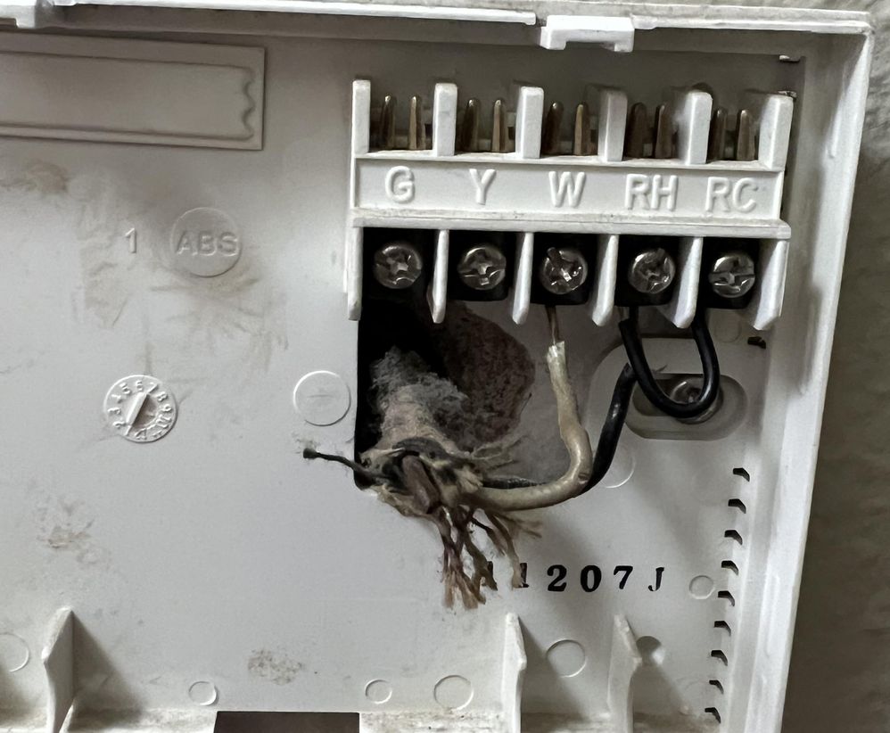

Here is a photo of my thermostat wiring. Is this compatible?
6 REPLIES 6
David_K
Do you have an older gas furnace built into the wall or the floor? If yes, then you probably have a millivolt heating system, which isn't compatible. If no, then you're good to use a Nest Learning Thermostat or Nest Thermostat E (Europe). This is based on the fact I can see you have the W, Rh and Rc wires, with a jumper wire from Rh to Rc. Only other thing on wires is you don't appear to have a common "C" wire, which in most cases isn't an issue, but mentioning it here for completeness. More details on that here.

LandonB
Everything is working after I installed the C-wire adapter. Thanks for the help!
