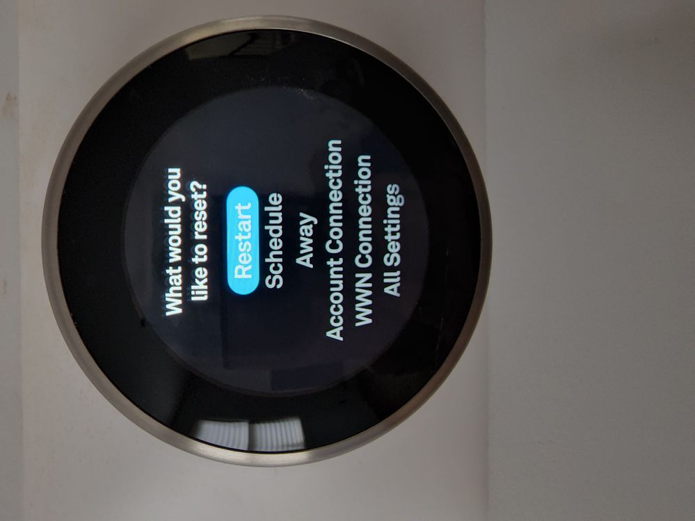

All 3 of my sensors went offline simultaneously as well. I removed the sensors, deleted my thermostat and reset it back to factory. I then added the sensors back. Worked fine for about 3 days and now they are all offline again.
Is my thermostat bad? I have the same set up at another home and have NEVER had any problem.
UPDATE -
I contacted GoogleNest support and they had an easy step that fixed my problem without having to reset to factory.
Go into your thermostat setting and all the way at the end is RESET, click the ring to navigate to RESTART. That brought all my sensors back on line. Quick and easy!!

Luvs2Bake
UPDATE -
