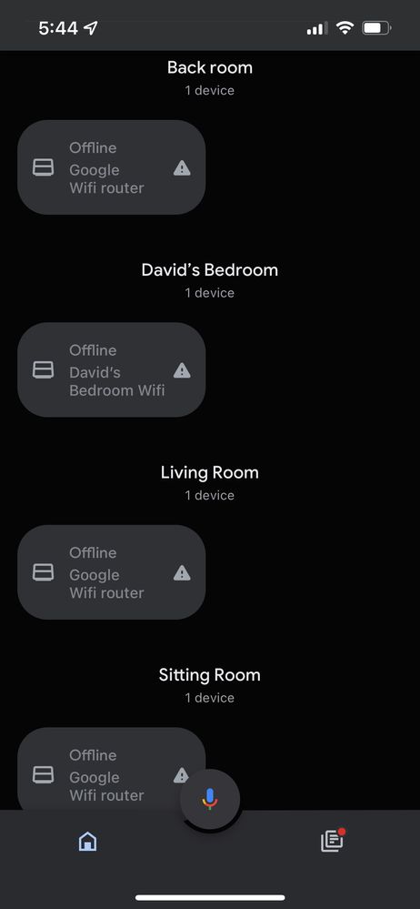

Pretty simple set up of original google home network, been working for years until recently
Office-Wifi connected to ISP modem, Model AC1304, software version 14151.43.81
FamilyRoom-Wifi mesh connection, Model AC1304, software version 14151.43.81
Both the devices were purchased from google in a 3 pack.
First issue, a few months ago, I don’t know the exact date but may have coincided with the forced switch to Google Home App; FamilyRoom-Wifi point starts going offline, at least it says so in the “home” app, and stays offline until re-boot/power-cycle. Note the Google Home App notification says the FamilyRoom-Wifi point is offline but the lights on the device don’t indicate a problem. What’s up with that?
Second issue, 2 Roku devices within 4 feet of FamilyRoom-Wifi point, the Home app shows device 1 excellent connection 2.4ghz, but shows a weak connection 5ghz for device 2. Device 1 is a relatively new Roku stick (2.4ghz) device 2 (5ghz) is a TCL Roku TV. Note, device 2 shows it has an "Excellent" connection while the Home app shows weak. What’s up with that?

Glad I found this thread.  Purchased 4 pack from Costco yesterday and installed today.  Thought I did something wrong during setup.  WIFI working fine so I'll bury the Google Home app into a MISC folder of apps I never open.

So I have the fix. I called Google and the fix is simple.
You have to change your ISP router/modem to bridge mode. I have Xfinity and I assume that when I upgraded my modem this problem started but I never made the correlation.
GregorF
Thank you, this worked for me as well. As soon as I set my 4G router to bridge mode, the Google Wifi router showed as online again. I didn't even need to restart the Google Home app, let alone any devices.

Latest update finally fixes the issue on iOS

Google Home update v2.60.108
As of 2.60.108 (2 days ago) according to apple store version history
Yes!  I have confirmed this works too
FJO
Yup, works for me too...
JedKalel
Yes after over 6 months google FINALLY fixed the issue with an update, well at least for iOS users, I don’t have android. But hooray google!!!
12atwood
I just installed Google Home version 2.60.108, uploaded Oct 26, 2022.  It shows all my wifi point as online (which it hadn't ever done before).  So perhaps the fix is available in this new version.
