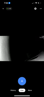

We just set up the Google Nest Indoor 2nd Gen camera as a baby camera. As you can see in the image below, the night vision is all but worthless due to focusing solely on the walls to left and right. Any idea how to fix this aside from moving the camera? We have a Nest IQ Indoor (2018) and it’s night vision is superb - never had an issue like this before.

Sorry to hear your Night Vision video quality is poor, I’m happy to help! Most Night Vision specific issues are caused by your camera’s infrared light that reflects off a surface near your camera.  If a bright white shape along the edge appears while everything else is too dark, there might be a surface that’s too close. That could be why if you had a previous baby monitor, or another camera emitting its own IR light, you may be experiencing this.
To fix this, angle your camera, so the surface stays out of view. If that doesn’t do the trick, take a look at this Help Center article about Night Vision video quality. There are more steps you should try to improve your video quality.

That's far darker than either our 2nd gen Nest Cam Indoor or our older Nest Cam Indoor.
You don't by any chance have "Night vision" turned off under Video in the camera's Settings, do you? Can you see whether the infrared LED lights on the camera come on at night?

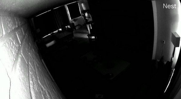

i have the same issues, at day. 3 camaras blurry screens with green tint and at night, night vission dark issues.
DJSuprimeW
here few pictures from mine, and a short giff from the beginning of the issue.
724d768f-6484-4e2c-a3a8-fdd942c84e13.jfif72a1544c-d75a-4096-8483-dc3affacbf59 (1).jfifc3f467db-3d9a-4175-8e56-f93ceb2396b8 (1).jfiffrom sharp to black/white/green flash to blurry and night vision issues. on 3 of my camera,s  sorry for the badd q/gifffrom sharp to black/white/green flash to blurry and night vision issues. on 3 of my camera,s sorry for the badd q/giff

yw! and yes its frustrating... it begin on wednesday. in the day. the gif was the first symptom/blurray/night vision issues.
This is how mine looks at night! Really bright edges but the middle of the picture is super dark

Looks exactly the same as mine. Thanks for sharing
