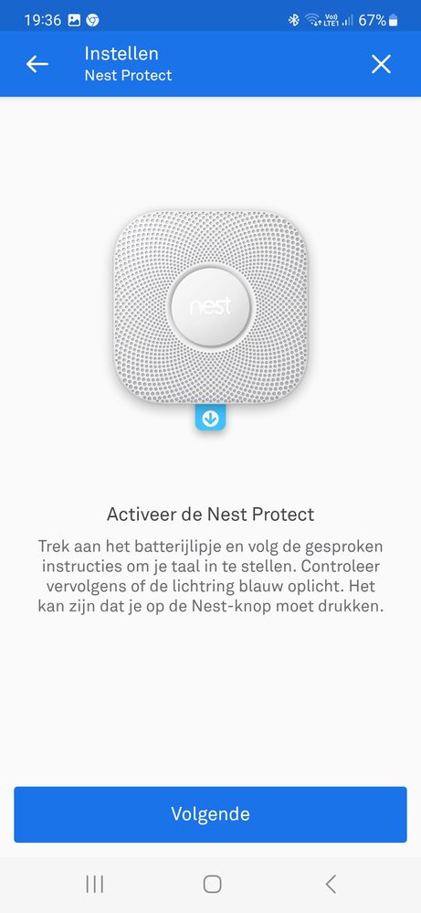

JeroenV
The one I'm trying to add is
Serial 06AA01AC241500xx
Error  code while connecting to the first (working?) Protect is p013 (4078)
Wim
3 Nest Protects with Nest code 062-00098-fd-a
Several error codes
Nest version -  2 Nests with version 3.5.0.3.
Nest version- 1 Nest with version 3.4.0.6.
Android 13
All 3 Nests were working fine for years without any issues. 14 days ago (friday) all Nest lost there connection in the app. After consulting the support they told me to remove them all from the app an reinstall them. That was not possible. I was able to reconnect 2 of them with version 3.5.30.3 in a SEPERATE HOUSE witch is not the best option because they are not connected anymore !!!!!! The 3th one on version 3.4.0.6. does not want to reconnect. Tried to do a factory reset on that one but this does not work. It is counting down but after this procedure the Nest Protect still says his "old" name so I presume the factory reset does not work. Is there a workaround to upgrade the version via USB cable or other solution.Screenshot_20231127_193539_Nest.jpgScreenshot_20231127_193557_Nest.jpgScreenshot_20231127_193606_Nest.jpgScreenshot_20231127_193616_Nest.jpgScreenshot_20231127_193622_Settings.jpgScreenshot_20231127_193630_Nest.jpgScreenshot_20231127_193634_Nest.jpgScreenshot_20231127_193638_Nest.jpg
