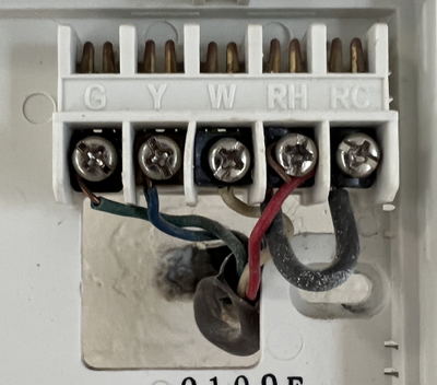

Trying to figure out the best way to get my Google Nest Thermostat (G4CVZ) to work with Google Nest Power Connector (GVN24). I found a few videos that show how to wire up the heater side but don't mention anything about the thermostat side. I have 4 wires running from my thermostat to my heater/cooler, unfortunately I can't run a 5th wire. I bought this power connector since I don't have the ability to run a C wire. My previous thermostat was wired up with the following config G (green wire), Y (blue wire) W (white wire) RH (red wire) RC (jumper ran from my RH to RC) my (White - Rodgers model #50A############) heater / cooler which has the following terminations capabilities Y, W, R, G, C. Any ideas? The Google Nest has the following terminations Y, C, W, G, R, QB.  Any help is greatly appreciated!!

Post a picture of your original thermostat's wiring.

Thank you for posting the picture.

Give this wiring diagram a try.
Patrick that is what is in the video & manual, again it is missing what wire goes where on the thermostat side. I %110 fully understand how to connect everything on the heater/cooler side, I am looking for a diagram on connecting the thermostat.
