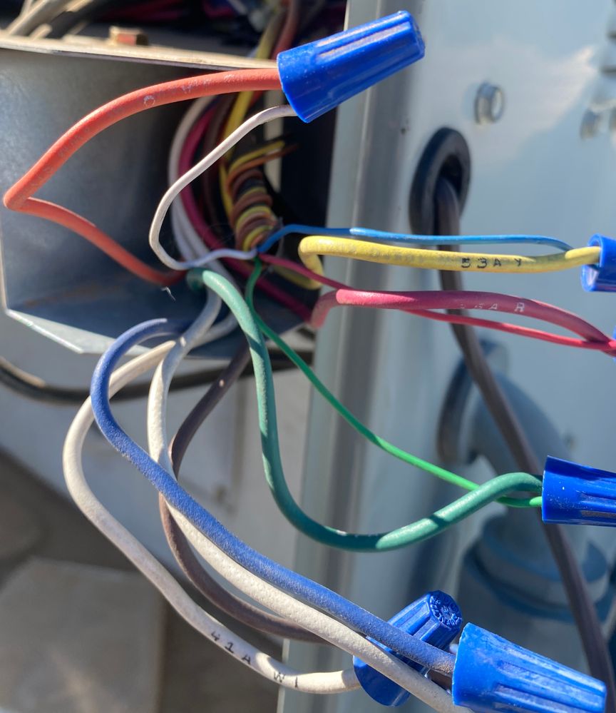

I installed a Nest a week ago it works, but I get errors messages saying it needs a power wire. I'm posting two pictures. The first is the wiring of my old thermostat. The second is of the Nest as currently wired. The white wire in the first picture is a jumper, going from W to Y, where the blue cable is. I'm not sure what I need to do to correctly wire the Nest so I don't get error messages. Is a jumper even an option? Thanks for any help.Old thermostatOld thermostatNest wiringNest wiring

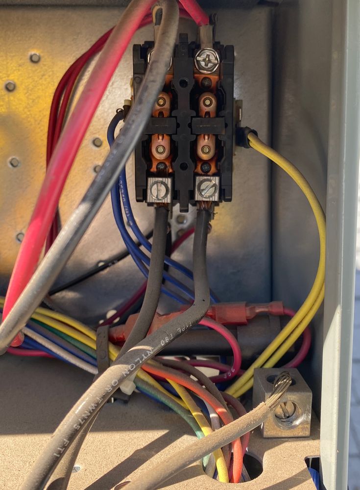

Is this the row of screw terminal you mean? If so, I'm still not sure which wire is the right one and how to connect it, to the Nest connector or look for it in the wall.Wires.jpg
Your picture is of the high voltage section.  See the group of wires going down that hole? Those are the control wires.  The wire nuts are used to connect the thermostat wires to the control wires.
Thanks! So, I went back up on the roof and found these under the unit, which I assume connect to the thermostat. The problem is there are still only four wires, and of the same colors as the ones inside in the wall attaching to the thermostat. Since there's no yellow wire there and there is one in the picture above, it must attach to something inside the unit. Does that sound right?

Your Trane Heat Pump is a packaged unit with return and supply ducts going from the outdoor heat pump to the inside of your house. So your thermostat cable goes from installation de the house out to the heat pump outside.  The picture below shows your connection between the thermostat cable conductors to the Trane terminal wires.

Here is the wire connections and their colors inside the heat pump.
Ok, the contractor that installed your system seems to have a blue conductor for the Y and they used White for the the reversing valve. Green is for the Blower Fan, and Red is the Power. So there is no 5th conductor for the common. So in the Low Voltage Connection Box, the Yellow wire is wire nutted to the Blue Thermostat wire. And the white wire is wire nutted to the Orange wire.  I did not see a second electrical contactor installed, so I do not think you have electric heat strips inside your heat pump.

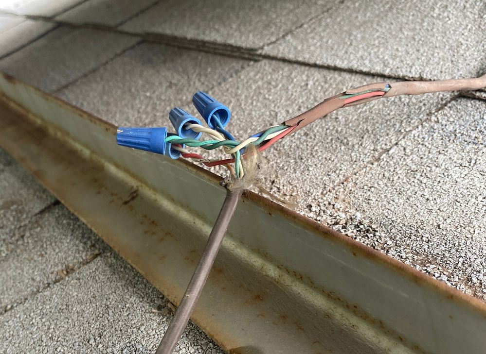

Thanks, yep, I did that. See pictures below, in response to Hooptee.

Your thermostat wire insulation looks like it is deteriorated from the sun. The wire nuts should not be outside of the unit like that exposed on the roof.
I would suggest run a new 5 conductor thermostat wire from the rooftop unit directly to your nest.

Thanks, that concerned me, too. I thought the thermostat cable went into the roof, but I went back up and saw it goes into the ductwork.

This set up sure does seem to confuse me. It looks like when that four conductor wire goes inside the Plenum duct, it comes out inside the unit on a seven conductor cable.  There is not likely to be enough room inside the low-voltage cable box to put the power connector in there. The power connector will most likely be on the outside of that box with the conductors being pass-through to the inside the low-voltage box.
I appreciate your help, Ken. Not sure how to hook up the connector given things like the white thermostat wire is nutted to orange unit wire. Also, can I attach the wires on the right side of the power connector to wires in the low voltage box, or do I have to run them to the panel as shown in the upper right side of the Nest power connector installation guide?

Let me see if I can help add some light to it OK. You pass the power connector wire through a hole for the area you will mount the power connector. You’re going to separate the little blue thermostat wire from the yellow number 53A by taking a wire nut off. .  Take the blue wire that was coming from the thermostat and connected to the W*Y on he left side with two wires next to the R. use the Wango connector provided with the Power connector.  Separate the red thermostat wire from the red 35A wire. Connect the red thermostat wire with a wango and the R wire from the left side of the power connector.  Now let us work on the right side of the power connector.  Take the W*Y from the group of three wires on the power connector, and connect to the yellow wire 53A with a wire nut.  Take the C wire on the right side and connect it with a wire nut to the Blue 36B wire.  Finally the R power connector wire and wire nut it to the red 35A wire.
I hope this helps.
Ken

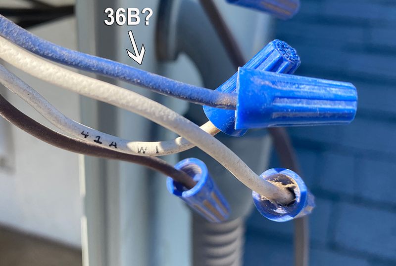

Will the Blue 36B wire have 36B marked on it? Also, is it likely the blue wire that's not attached to anything (with just a nut on it) in the low voltage box and pictured below.
I am pretty sure it is, the wire will the number 36B printed on it. If it was bundled with the others, strong chance it is indeed the common wire.
