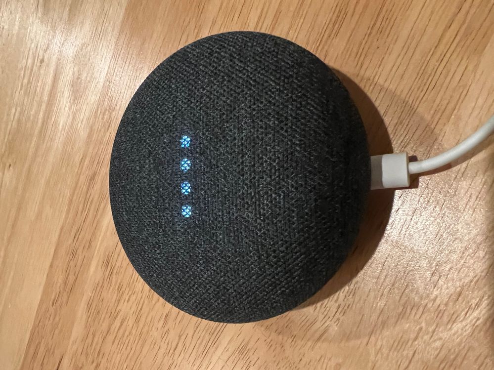

Hi guys, here´s thread for anyone who´s experiencing "Google home mini 4 dots stuck problem". Possible news from Google, solutions or fix to be written here. Seems this issue affected lot of devices, let´s see what can be done about it and what will be Google´s reaction to this situation.

Same issue, 4 fixed dots, even I tried to reboot 10 times and reset procedure with no luck.
12-18-2023 08:29 AM
Sorry for the delays. I've duplicated this thread for a similar trending issue. Our team is aware of this and looking into this issue at hand.
In the meantime, we kindly ask you to please go through the "Recommended Answer" provided and provide us with any necessary information that will assist us in our investigation.
Muddi
12-19-2023 08:45 AM
No disrespect, but I've read the thread and done everything asked. It's the same for everyone.
4 white lights solid.
unplug. wait. replug.
2 white lights solid, then all 4.
Hold reset button? One light goes green. Nothing every factory restores.
App and networks can't use the device.

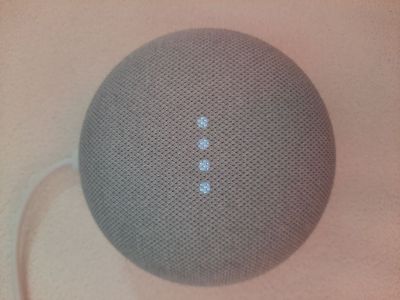

12-16-2023 07:59 AM
At the electrical connection !
After 5 Second
If I press the Reset button
If I press the Reset button at the electrical connection
After 5 second (press the Reset button at the electrical connection)
When i release the reset button
