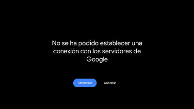

I had the same situation.
Update + Factory reset didn't fix the issue for me as well.
I had to change the system language from native (Hebrew) to English  for both chromcast device and google home device (Tablet in my case).
That's the only way I succeed to conect google servers correctly (for both: chromcast auto setup and remote buttons setup).
