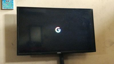

This issue just started for me. I saw an old thread talking about this. The trouble shooting does not fix the issue. Disconnected the power supply. Manual factory reset doesn’t work. It’s just frozen. Remote doesn’t work. I reset my Wi-Fi. I changed HDMI ports, still Not working. I have two of those on n my house and the other is fine. I’ve plugged into different TVs and everything nothing works same issue. Help!!! Even the reset button doesn’t work on the Chromecast

12-30-2022 12:08 PM
I am also experiencing the same issue. It has become useless now.

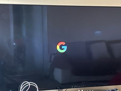

Same issue, frozen on G logo.

Add me to the list, as well. Mine was working fine last night, and then this morning, it was bricked when turning on the device. It does nothing but displays the G. I sent a message through the form that Jennifer suggested to another in a different thread.

same issue for me. Resetting button does nothing (no light color changes). Stuck on G logo. Tried different TVs. Tried different power cords . I have two Google Tv units, and the other is fine. Unplugged and waited a day, no there is no light on the unit.
