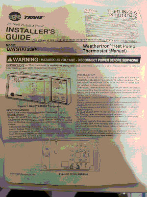

Compatibility to Thermotron Thermostat
See attached pic:In compatibility checker it states I need support. Not sure how to wire to nest. Appreciate any helpI have starting clockwise on picture: G, O, X2, B, W, U, R, T, Y. W and U have a soldered bridge. My understanding is X2 is for Emerg...
