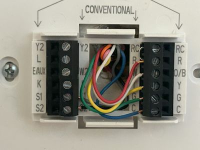

Having trouble figuring out old existing wiring configuration to setup 3rd gen nest. I have a w/e wired to a w/2 and a white cable going into the w/2 Existing/Old System:C - blue wireO - orange wireW/E - red wire feeding into W/2W2 - white wire also ...
